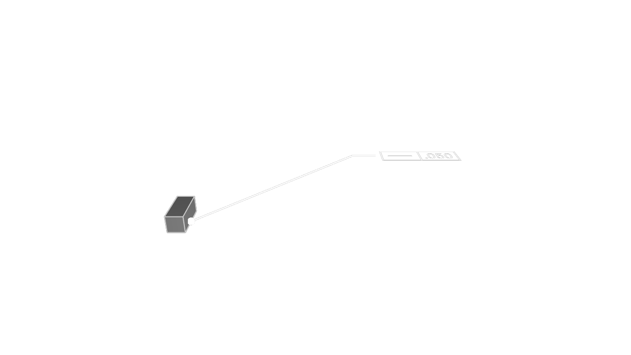

Rendered example of gdt::straightness 0

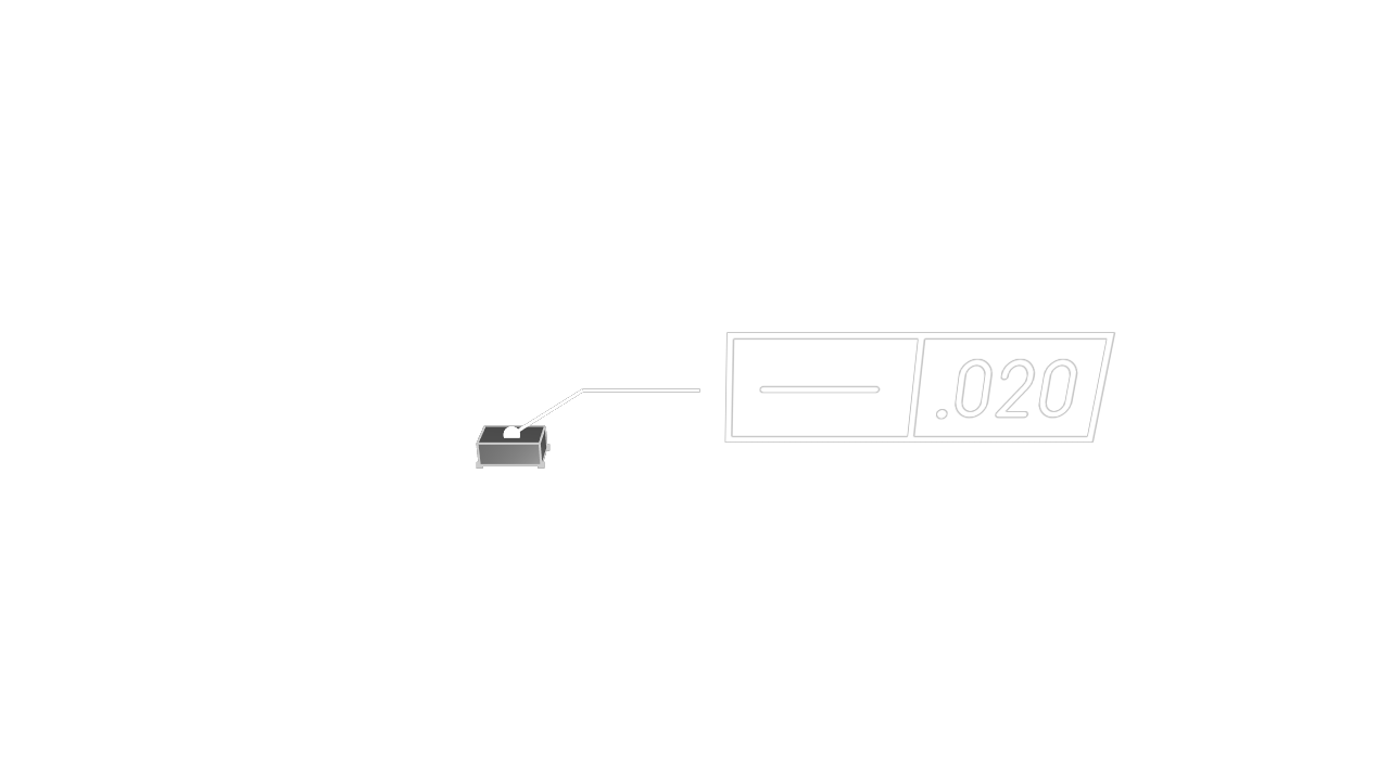

Rendered example of gdt::straightness 1
