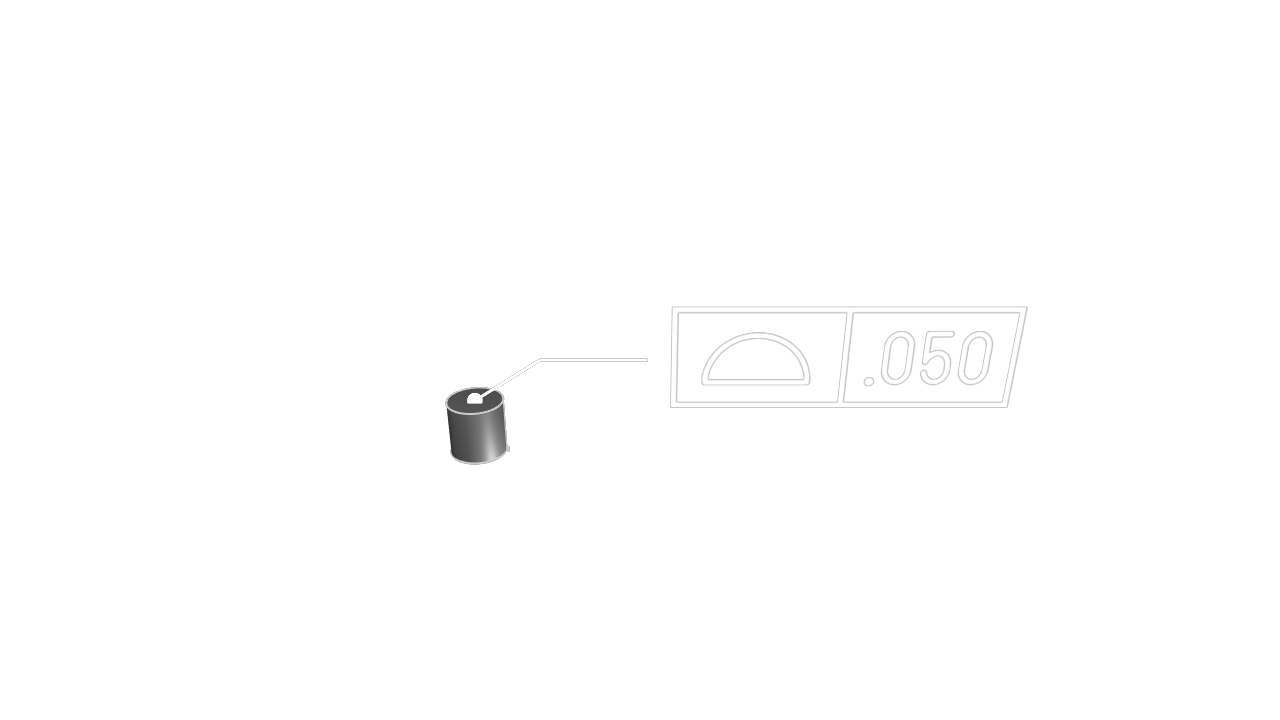

gdt::profileSurfaceFunction in std::gdt
GD&T profile-of-a-surface annotation specifying how much faces may deviate from their ideal shape.
Profile of a surface is a three-dimensional tolerance zone that applies across the whole annotated surface.
