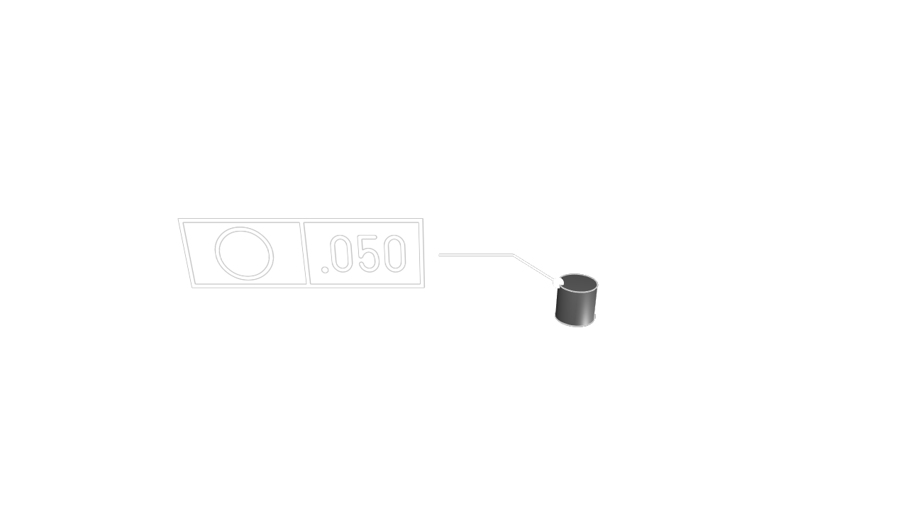

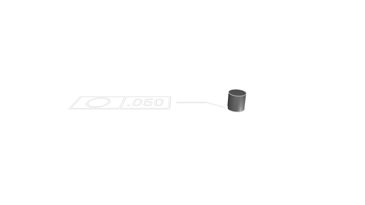

GD&T annotation specifying how circular (round) a feature must be.
Circularity is a form tolerance. It controls how much a feature of revolution may deviate from a perfect circle. When applied to a circular edge, every point of the edge must lie between two concentric circles whose radii differ by the given tolerance. When applied to a round face, such as the wall of a cylinder or cone, every cross-section perpendicular to the axis must meet that same requirement.
Circularity is a form tolerance, so it does not reference datums.
