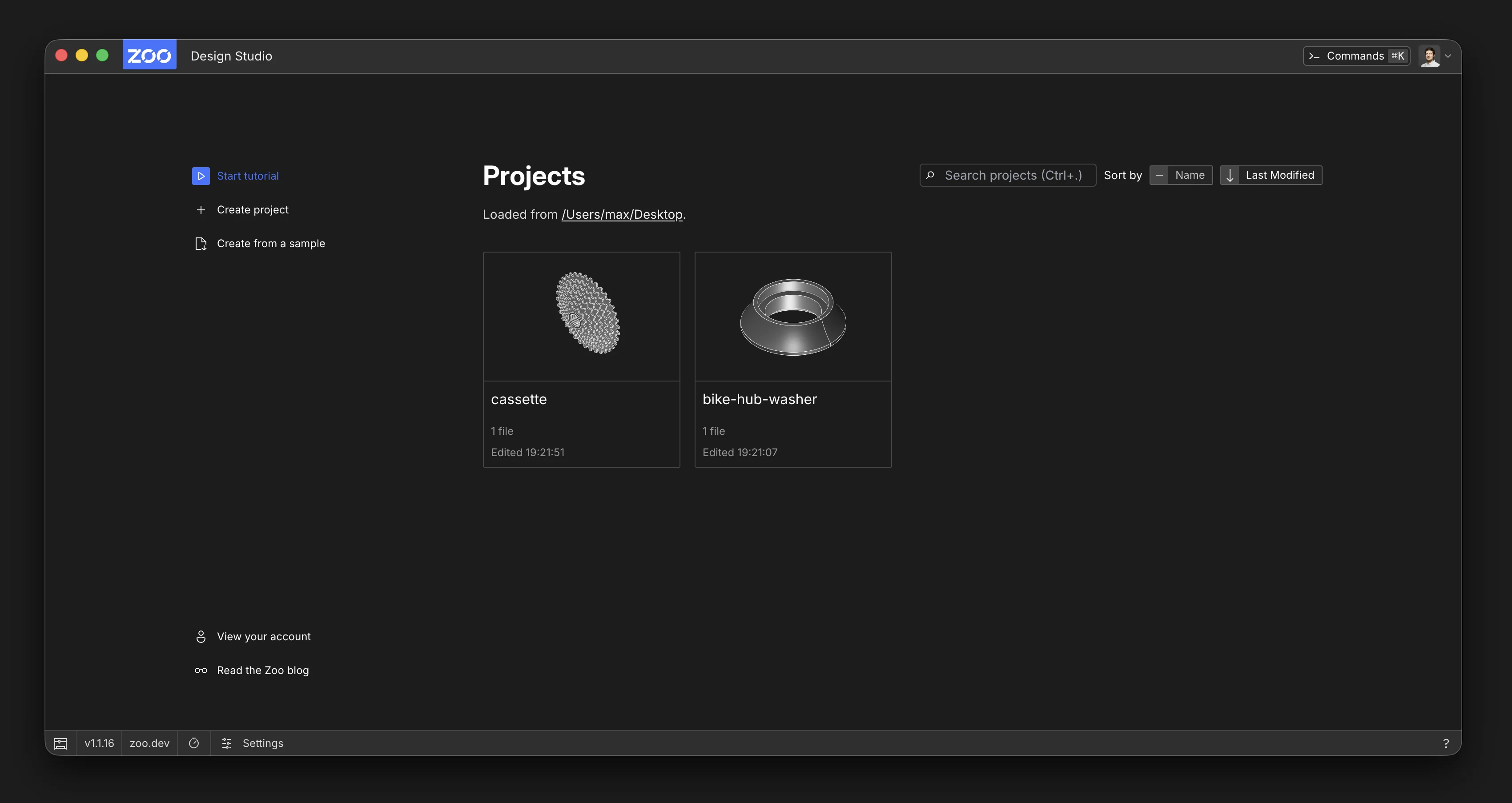

Project Browser
The Project Browser is your home screen for project-level work.
Zoo Design Studio project browser
What You Can Do
  • See projects grouped by Project Libraries.
  • Search projects by name.
  • Sort projects by Name or Last Modified.
  • Create a project.
  • Create a project from a sample.
  • Open a project.
  • Duplicate a project.
  • Rename or delete a project (if you have write access).
  • Move projects between libraries.
  • Review duplicate local copies of the same cloud project.
  • Open Project Libraries settings.
  • Inspect cloud sync status badges, including cloud-only, synced, blocked, conflicted, and duplicate projects.
  • Inspect Aquarium publication statuses, including pending review, published, changes requested, and rejected.
Aquarium Publication Status
Aquarium publication status is separate from project storage and Cloud Sync status. Published means an approved version of the project is public in Aquarium. Pending Review, Changes requested, and Rejected describe the review state of the submitted version.
Editing or syncing the Personal Cloud project does not automatically update the submitted Aquarium version. Open the project's Publish dialog to update the submission. See Aquarium for details.
