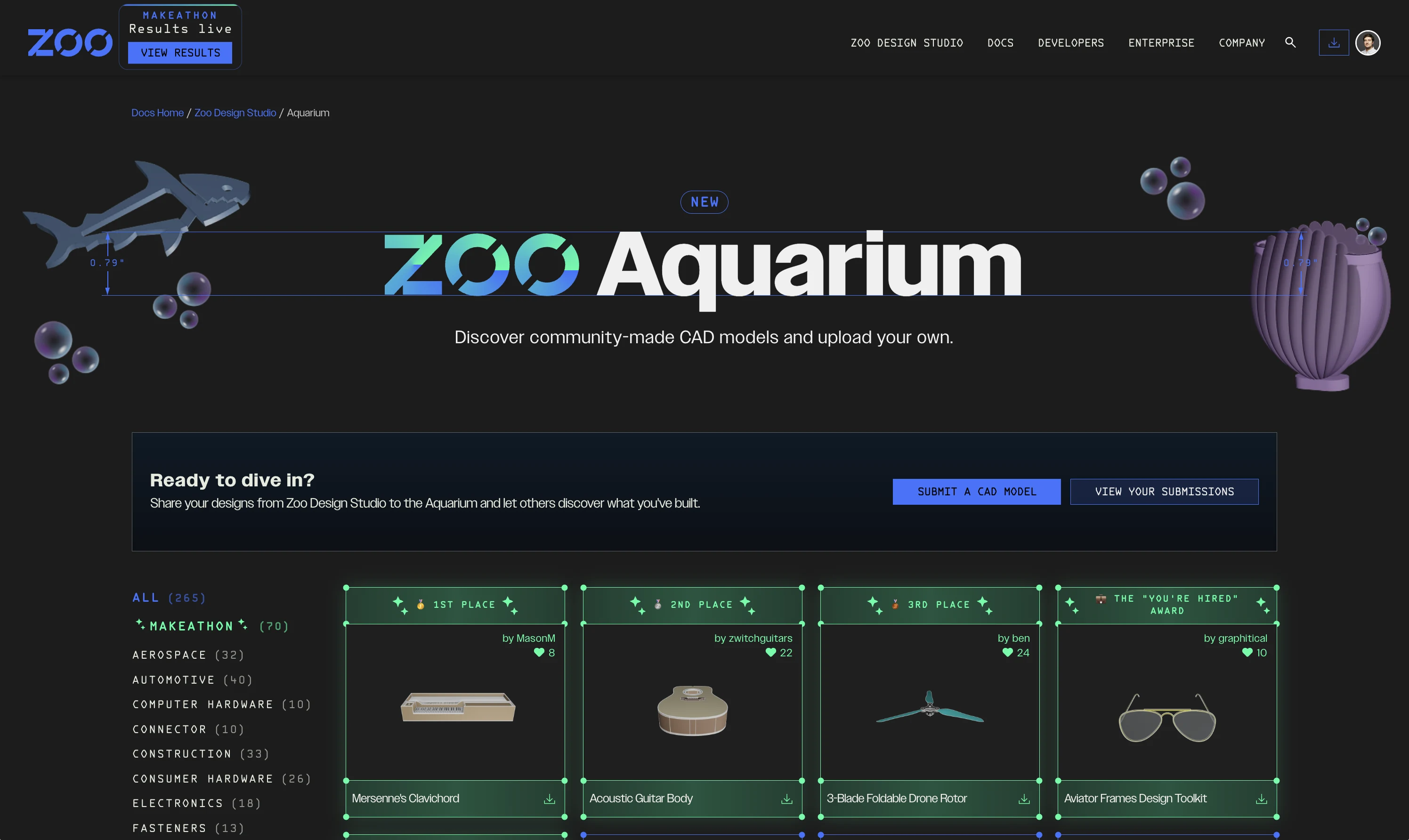

Aquarium CAD Gallery page with public model cards
Aquarium shows public CAD models that can be browsed, opened, and shared
