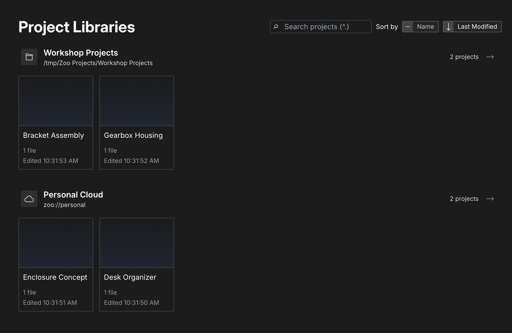

Zoo Design Studio adds Personal Cloud automatically for signed-in users. On desktop Home, it appears beside Directory libraries with a cloud icon. Directory libraries have folder icons and show normal paths on your computer, the default one is titled "Default Projects Directory". In the browser, Personal Cloud is the only project library.
Home showing a Directory library with a folder icon and local path beside Personal Cloud with a cloud icon and zoo://personal address

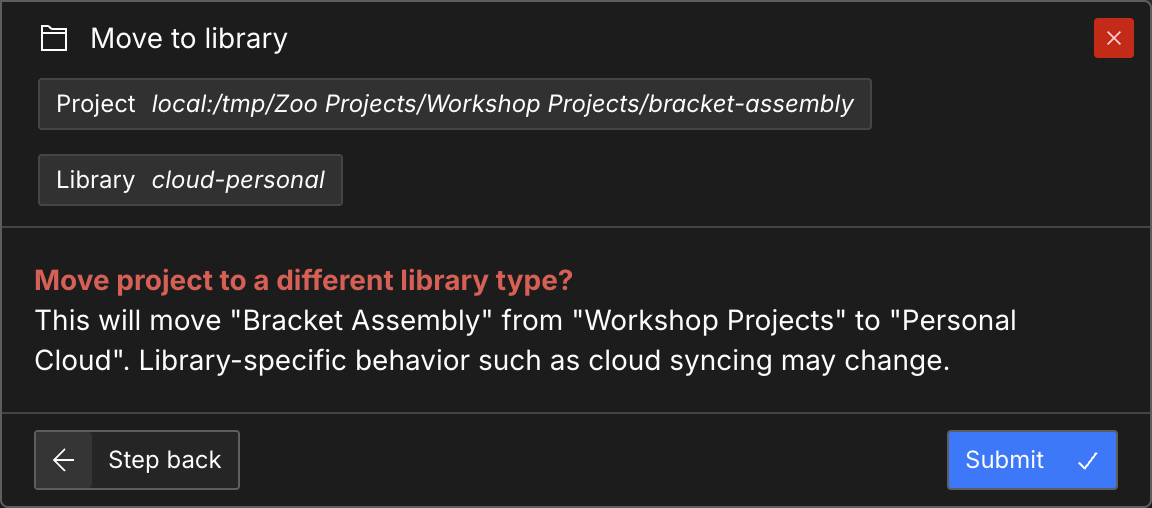

Start Syncing
To start syncing a local Directory project directly, move it to Personal Cloud:
  1. Select Move to library from the Command Bar, the project menu in the top bar, or the project card context menu on Home.
  2. Choose the local project.
  3. Choose Personal Cloud as the destination library.
  4. Confirm the move.
Zoo Design Studio moves the project into the cloud library and keeps a local working copy for normal editing. If cloud sync is enabled, it uploads the project to your Zoo account; if cloud sync is paused on desktop, the project remains local in that folder until you enable it again.
Creating a project directly in Personal Cloud also starts it as a synced project. In the browser, Personal Cloud is the only project library, so projects are cloud-backed by default.
Publishing a Directory project to Aquarium also moves it into cloud storage. The submission dialog warns about the move before you submit. After a successful submission, Zoo Design Studio moves the folder to Personal Cloud, reopens it there, and starts cloud sync. Publishing a project that is already in Personal Cloud does not move its working copy.
Move to library review for moving a Directory project into Personal Cloud

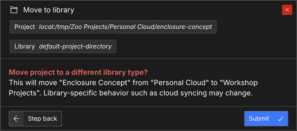

Stop Syncing
To make a synced project local-only, move it from Personal Cloud to a Directory library:
  2. Choose the synced project.
  3. Choose a Directory library as the destination.
Zoo Design Studio disconnects the project from cloud sync and moves the files into the selected local library. The moved local copy is the project that remains, and future edits happen only in that Directory library unless you move the project back to Personal Cloud.
Important: Moving a project from Personal Cloud to a Directory library deletes the remote cloud project before moving the remaining local folder. The cloud project is no longer available in the browser or on other devices. If the project has an Aquarium publication, deleting the cloud project also deletes its public Aquarium entry. If remote deletion fails, Zoo Design Studio restores the cloud link and the move fails.
Turning Cloud Sync off only pauses synchronization; it does not make a project local-only. A cloud-only project must first be opened and downloaded before it can be moved.
Move to library review for moving a Personal Cloud project into a Directory library

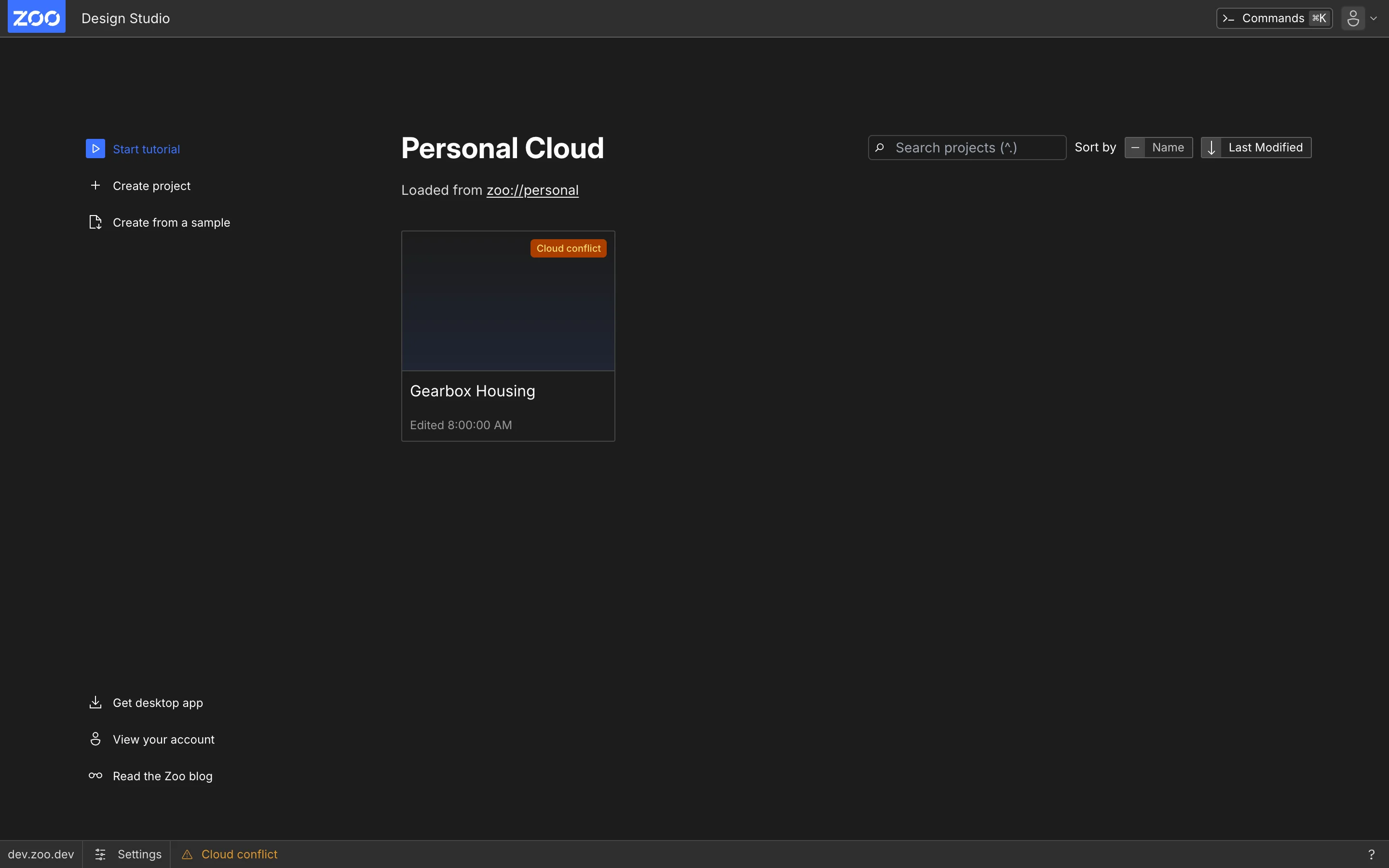

Resolve a Conflict
A cloud sync conflict happens when the local project and the cloud project both changed after the last synced version, and Zoo Design Studio cannot safely combine the changes automatically.
When a conflict is detected:
  • The project card on Home shows a Cloud conflict badge.
  • The project breadcrumb can show a Cloud conflict badge while the project is open.
  • The Home status bar (bottom-left corner) shows Cloud conflict; select it to list conflicted projects.
  • The open project's menu (top-left corner) shows Cloud conflict; select it to open the dialog.
Zoo Design Studio keeps your current local project as the primary project while you review the conflict.
Home showing Cloud conflict on a project card and in the status bar

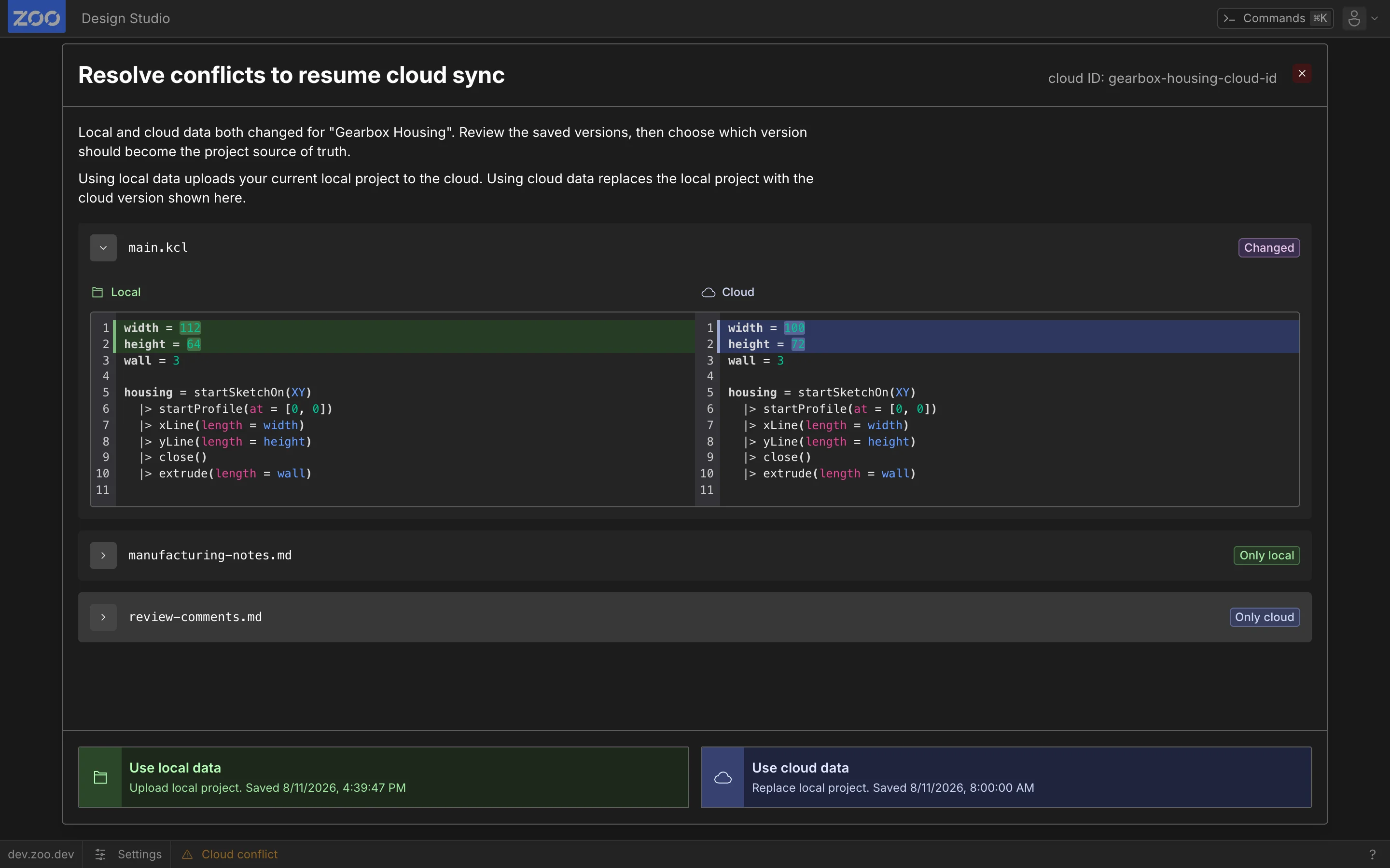

Open the conflict dialog from the project menu or from the cloud sync status UI. The dialog compares the local version and the cloud version file by file.
Files are labeled as:
  • Changed, when local and cloud both have the file but with different contents.
  • Only local, when the file exists only in the local project.
  • Only cloud, when the file exists only in the cloud project.
Text files, including .kcl and Markdown files, show a side-by-side diff when possible. Large, binary, or non-UTF-8 files may show file metadata without an inline diff.
The resolution applies to the whole project, not individual files. Choose one resolution:
  • Use local data uploads the current local project to the cloud, clears the conflict, and resumes sync from the local version.
  • Use cloud data replaces the entire local project with the cloud version shown in the dialog, clears the conflict, and resumes sync from the cloud version.
If you need to combine both versions, manually copy or edit the files you want into the local project first, then choose Use local data.
You may want to back up the local folder before choosing Use cloud data, especially if it contains ignored or version-control files.
Cloud conflict dialog comparing changed, local-only, and cloud-only files with options to use local or cloud data

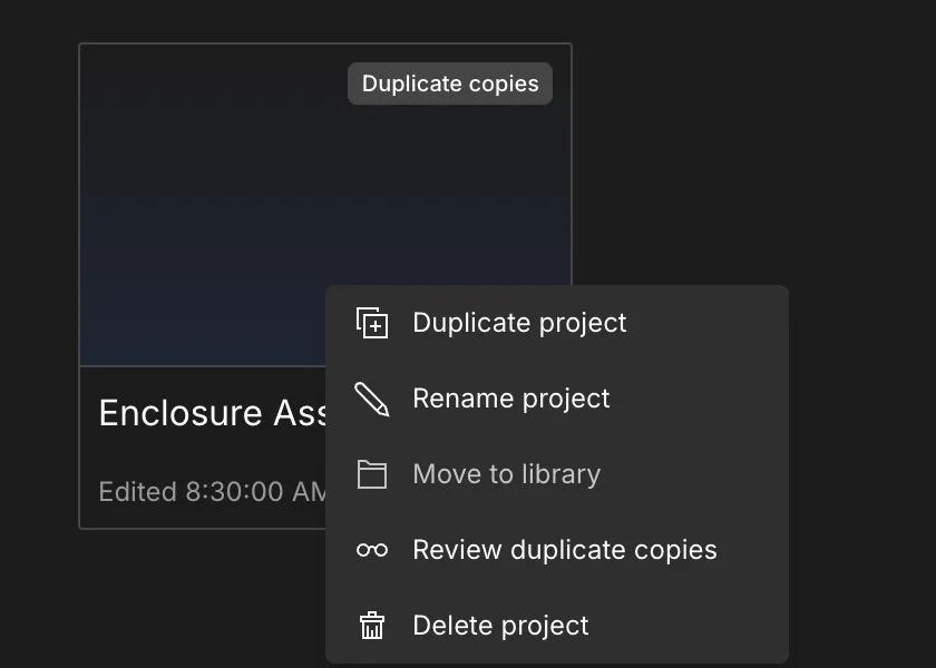

Duplicate Local Copies
A cloud project can have more than one local copy. This can happen if you copy a synced project folder in Finder or File Explorer, restore one from a backup, or keep overlapping project library folders that both include the same project.
Zoo Design Studio tracks this as one cloud project with one or more local copies. Home picks one canonical copy to open and sync from, then marks extra copies with a Duplicate copies badge.
Duplicate copies are handled conservatively:
  • The canonical copy is kept.
  • Extra local copies are not hidden just because they share the same cloud project ID.
  • Directory library copies are not silently deleted.
  • Zoo Design Studio may clean up an exact duplicate in the cloud library only when it can prove that copy matches the clean synced version.
  • Pending, conflicted, unreadable, tombstoned, sync-excluded, or changed copies stay available for review.
Ignored files and version-control metadata do not make an otherwise exact extra copy divergent, so automatic cleanup can remove that excluded content with the duplicate folder.
Use Review duplicate copies from the project card context menu to inspect duplicate local folders. You can select duplicate folders to permanently delete, and Zoo Design Studio will still keep the canonical folder. This review action removes selected local folders; it does not delete the cloud project.
Project card with a Duplicate copies badge and the Review duplicate copies menu action
