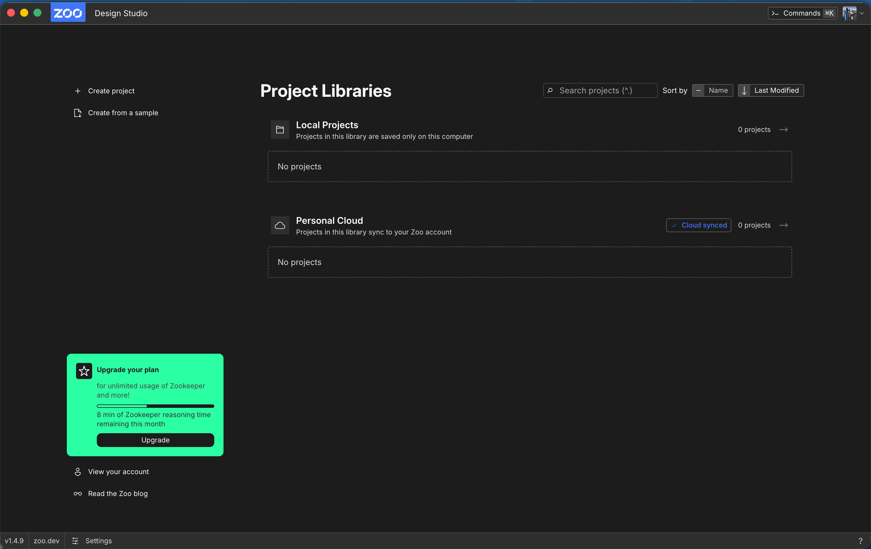

Home showing a Directory library with a folder icon and local path beside Personal Cloud with a cloud icon and zoo://personal address

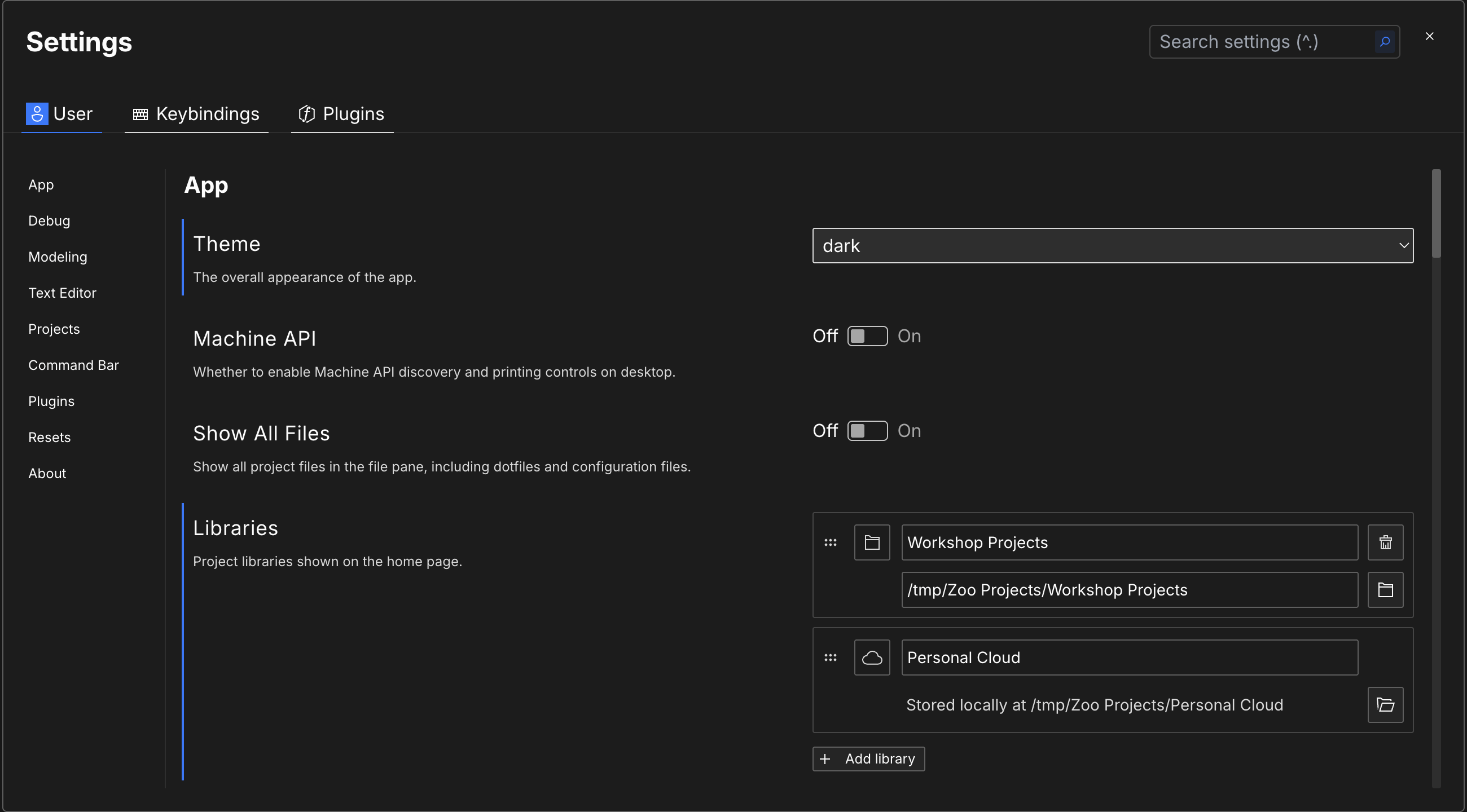

Directory libraries are available in the desktop app. Under Settings > User > App > Libraries, you can add more than one, rename them, choose different folders, reorder them, or remove them from Home. Changing a library path changes which folder Home scans; it does not move projects. Removing a Directory library does not delete its folder or projects on disk.

On desktop, Personal Cloud uses its own managed folder, separate from your Directory libraries. When you create or open a cloud project, Zoo Design Studio puts a working copy in that folder and syncs your changes in the background. The Personal Cloud settings row shows the folder's path and can reveal it in your file explorer.

User App settings showing an editable Directory library and the Personal Cloud local storage path

With multiple libraries, Home shows a Project Libraries overview in configured order. Select a library to see all of its projects, then use All libraries to return to the overview. With only one configured library, Home goes directly to that library's projects.

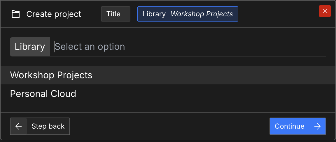

From Home, choose Create project. If more than one writable library is available, the Create project command includes a Library field.
Creating a project in a Directory library creates a new folder inside that Directory library's path. Creating a project in Personal Cloud creates a local cloud working copy and starts cloud sync when sync is enabled.
Create project command showing Workshop Projects and Personal Cloud as library choices

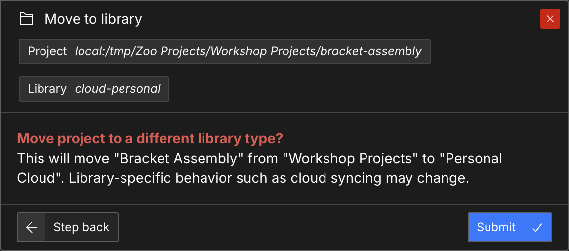

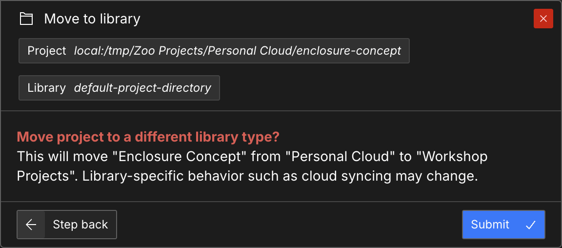

Use Move to library to change where a project lives. You can start this from the Command Bar, the project menu in the top bar, or a project card's context menu on Home.
  1. Select Move to library.
  2. Choose the project.
  3. Choose the destination library.
  4. Confirm the move.

  • Directory to Personal Cloud moves it into managed cloud storage and starts cloud sync.
  • Personal Cloud to Directory deletes the remote cloud project, disconnects the local copy, and moves that remaining folder to the Directory library.
A cloud-only project must be opened before it can be moved. Moving out of Personal Cloud also requires Cloud Sync to be enabled.
Important: Moving out of Personal Cloud is a permanent remote deletion, not a way to retain both copies. If the project has an Aquarium publication, moving it out of Personal Cloud deletes that public entry too. If Zoo Design Studio cannot delete the remote project, the move fails and restores the cloud link.

Publishing a Directory project to Aquarium is a special case of the Directory-to-Personal-Cloud move. The publishing dialog discloses the storage change before submission. After a successful submission, Zoo Design Studio moves the project folder into Personal Cloud and reopens it there; it does not leave another project in the Directory library.
Move to library review for moving a Directory project into Personal Cloud
Move to library review for moving a Personal Cloud project into a Directory library
