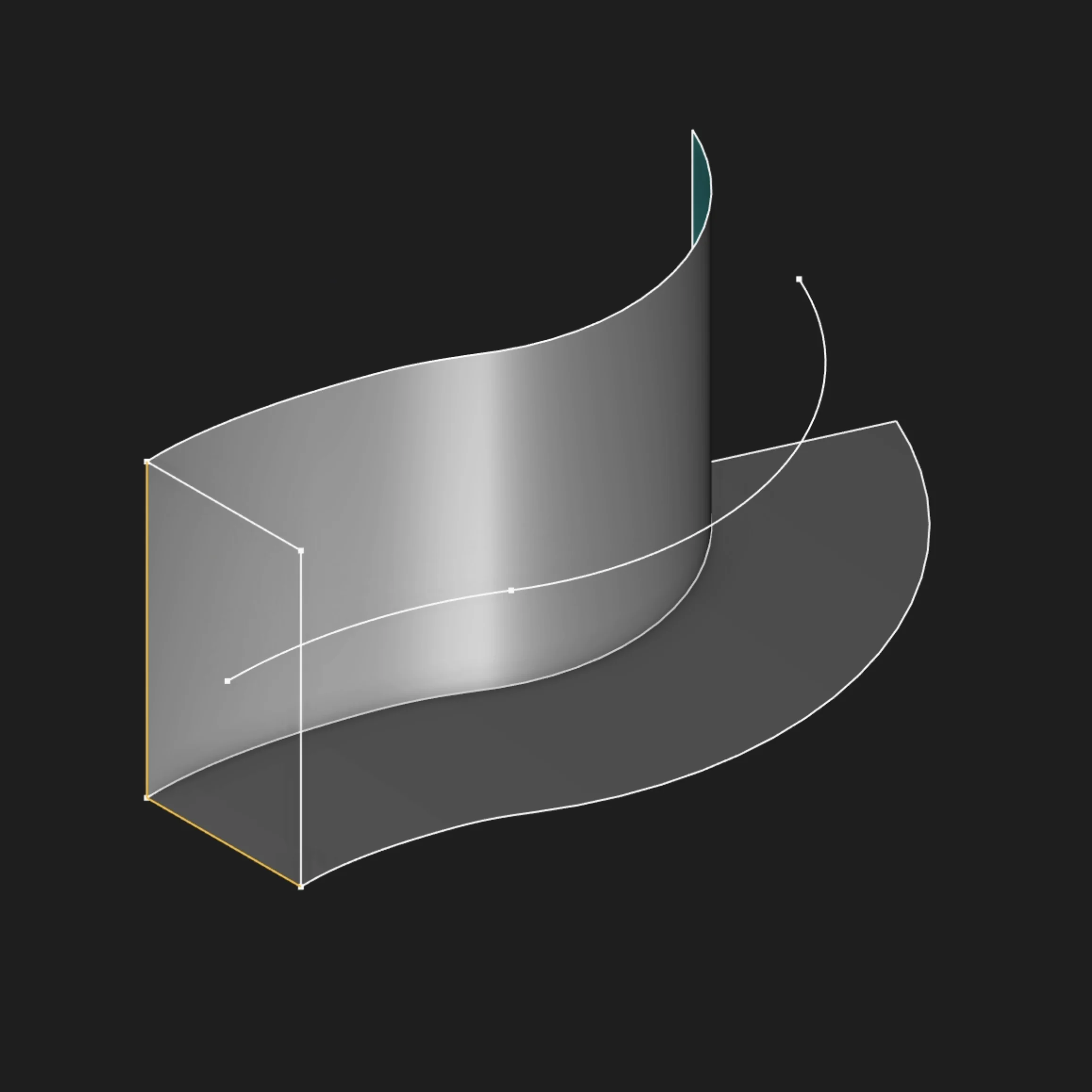

Use the same Sweep tool used in Sweep Solid, then set bodyType to surface to carry a profile along a path as an open surface instead of a closed solid. This is useful for guide surfaces, routed surface geometry, and path-driven forms that should stay open for later surfacing operations.
Surface sweep workflow in Zoo Design Studio
Body Type
The bodyType parameter controls whether Sweep creates a solid body or a surface body. Set bodyType to surface when you want a shell with no thickness instead of a solid body. This works the same way as the Body Type option in the solid Sweep workflow, you are just choosing the surface output mode here.
Sweep tool with bodyType set to surface in Zoo Design Studio

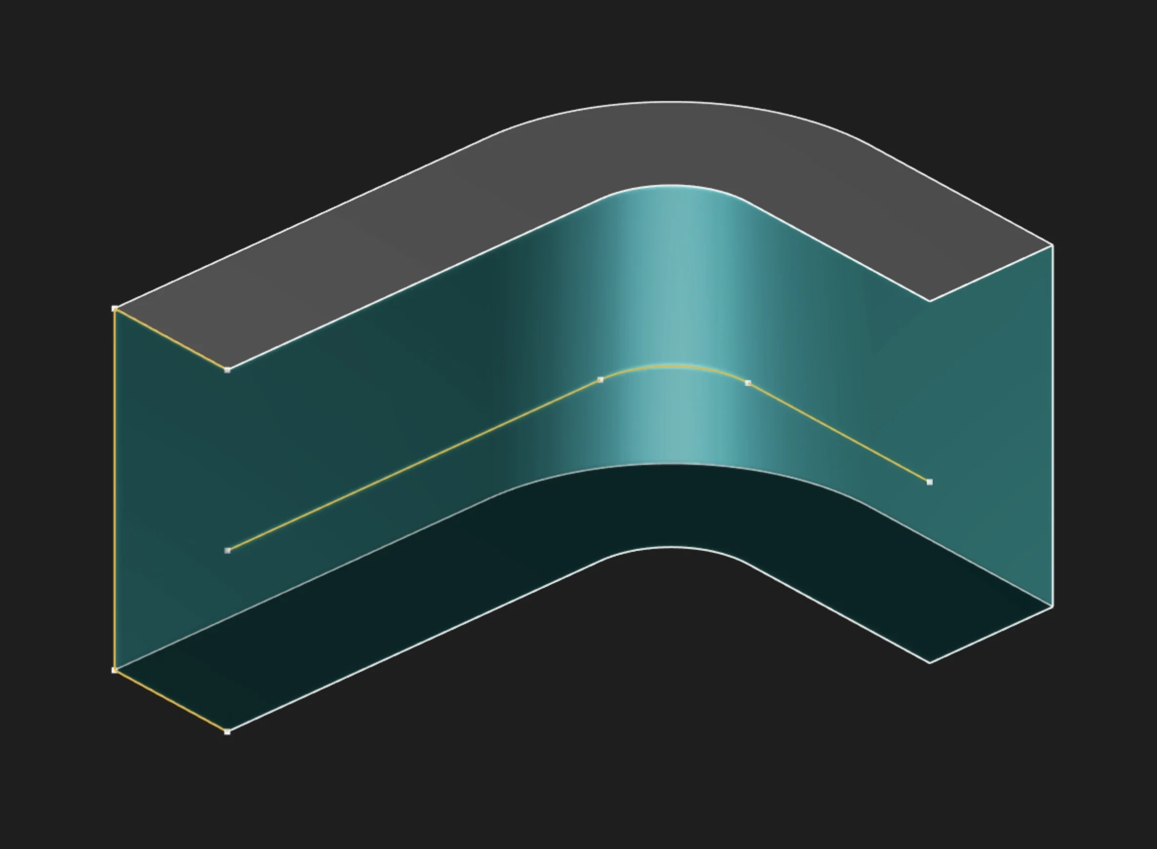

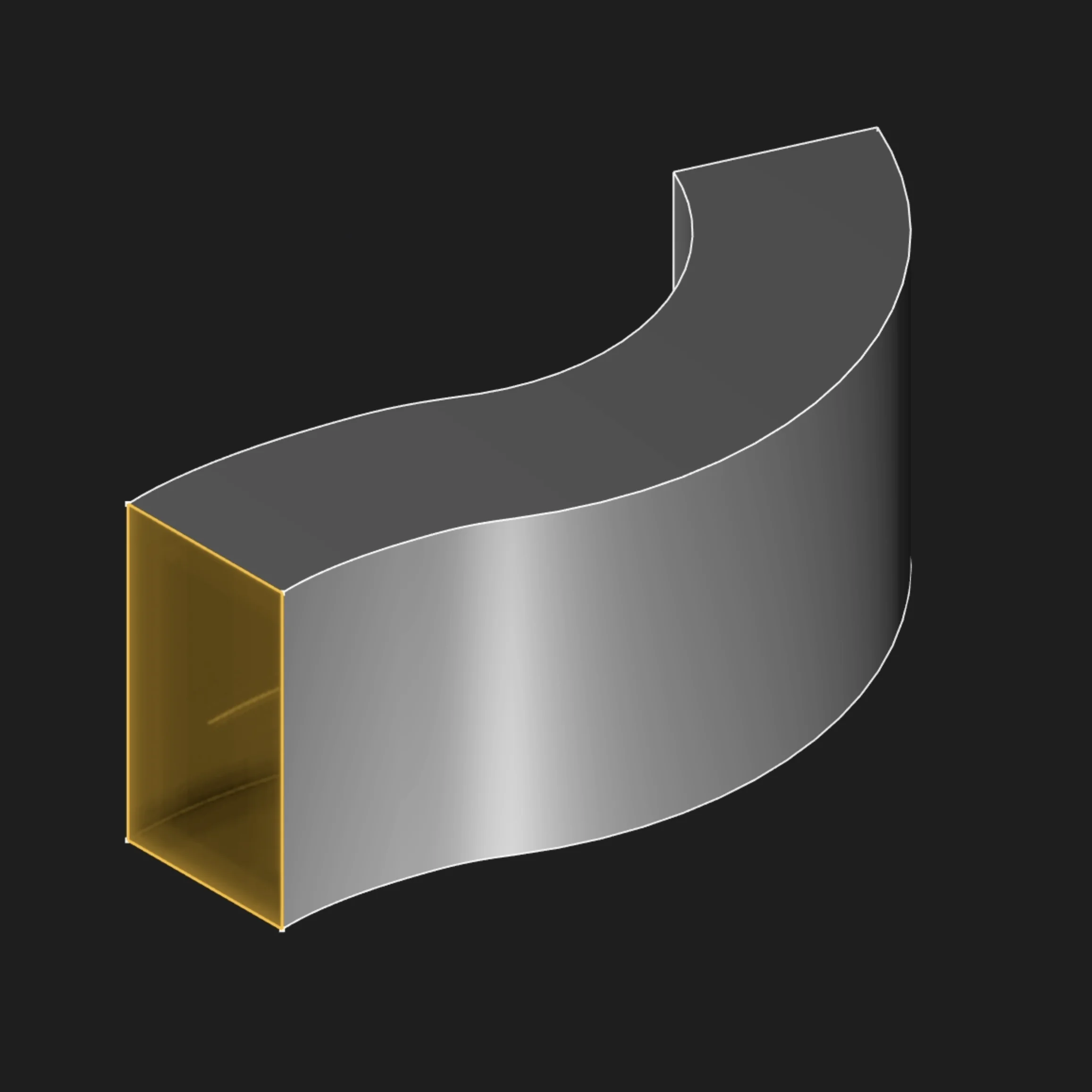

Selection
Choose a sketch segment when the surface should use a single edge as its profile. If the sketch forms a closed region, choose the region to use the full enclosed profile instead.
Sweep surface with a selected segment
Selected sketch segment
Sweep surface with a selected region
Selected sketch region

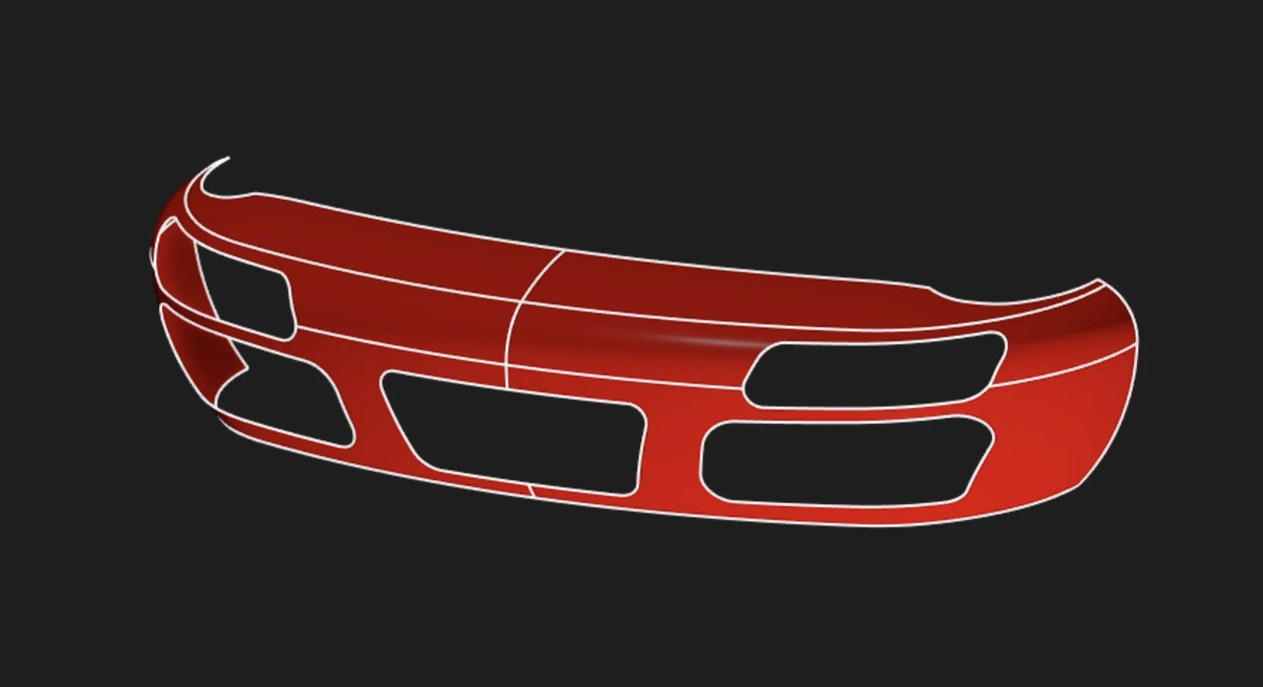

Surface Sweep In The Aquarium
For a real model that uses Surface Sweep, open this car bumper in the Aquarium, our public model gallery.
Car bumper model using Surface Sweep in the Aquarium

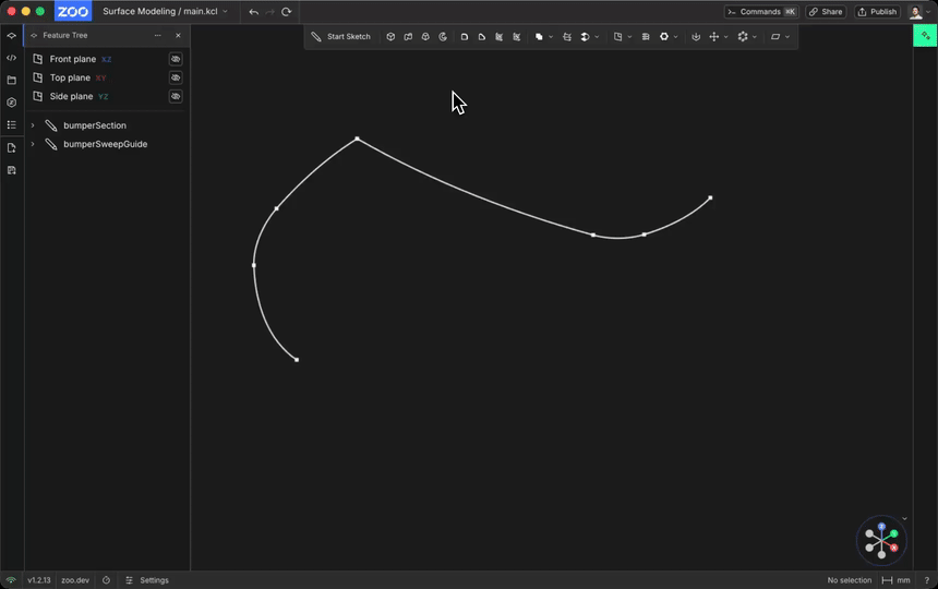

Are you interested in code?
Zoo Design Studio writes KCL behind the scenes. A surface sweep is just a sweep call with bodyType = SURFACE, applied to sketch segments and a path.
Want to find out more about the sweep function? Check it out in our KCL docs.
