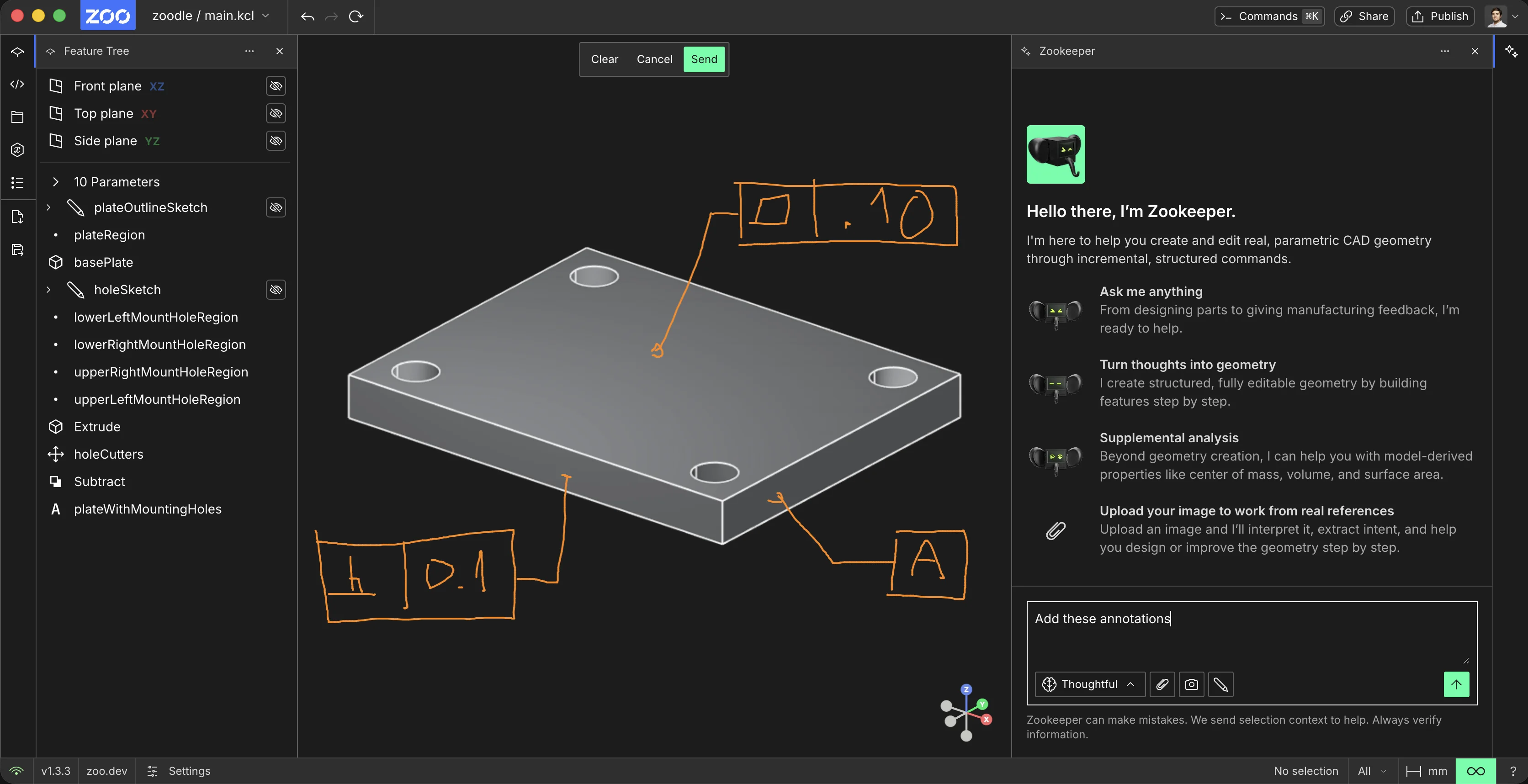

1. Mark the annotation target
Open Zoodle while the relevant face or feature is visible. Draw the callout, leader, or box close to the target geometry so Zookeeper can tell what the annotation belongs to.
Using Zoodle markup to request datum, flatness, and perpendicularity annotations on a generated plate

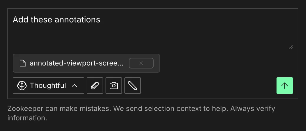

2. Describe the annotation
Send the marked image with a prompt that names the annotations and any tolerance values. For example, you can ask Zookeeper to add a datum, flatness tolerance, perpendicularity tolerance, or other supported MBD annotations to the marked features.
Zookeeper prompt composer with an annotated viewport attachment and the prompt Add these annotations
If Zookeeper asks which GD&T standard to use, choose the standard for your drawing set, such as ASME Y14.5 or ISO 1101.
If the target is ambiguous, rotate the model and capture another Zoodle markup from a clearer angle.

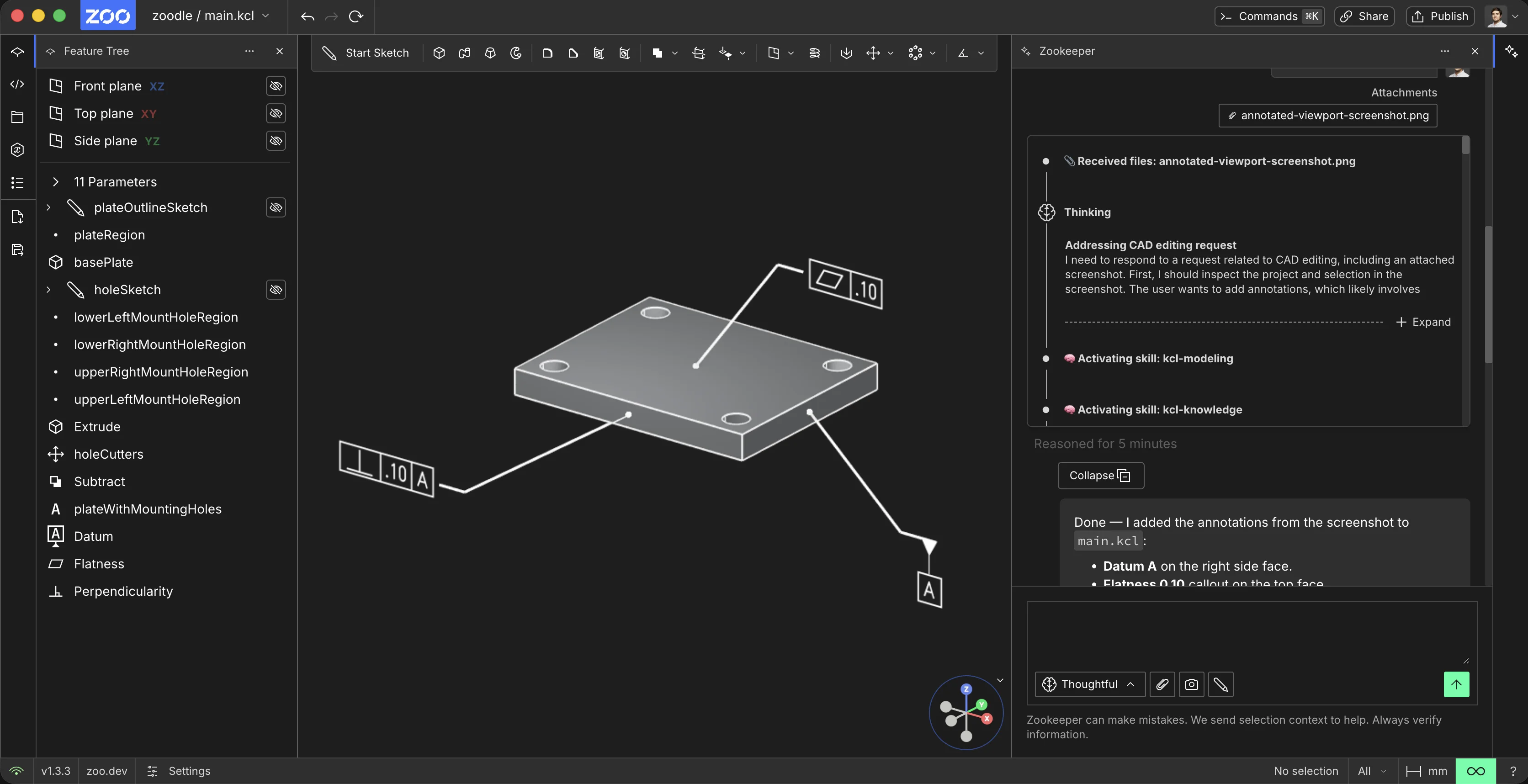

3. Review the model
After Zookeeper responds, inspect the annotation placement and the updated model context. Verify each target feature, callout value, datum reference, and tolerance before continuing.
Zookeeper result showing datum, flatness, and perpendicularity annotations on the generated plate
