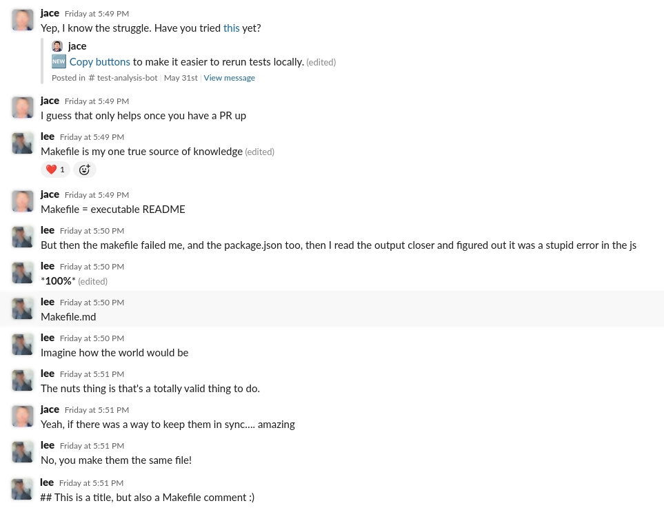

On Friday (this article is posted on a Sunday), trudging through the Playwright mines (a test framework typically for web applications), my coworker Jace said something that immediately triggered me to do what this article details:
jace and me talking

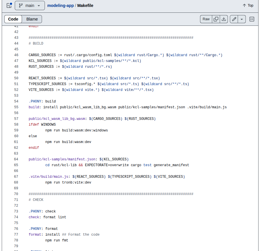

As soon as I opened our project's Makefile, it became crystal clear just how compatible Markdown could be with Makefiles, partially thanks to how Jace wrote it:
design studio's Makefile
Oh my god, a Makefile comment looks just like a Markdown header!

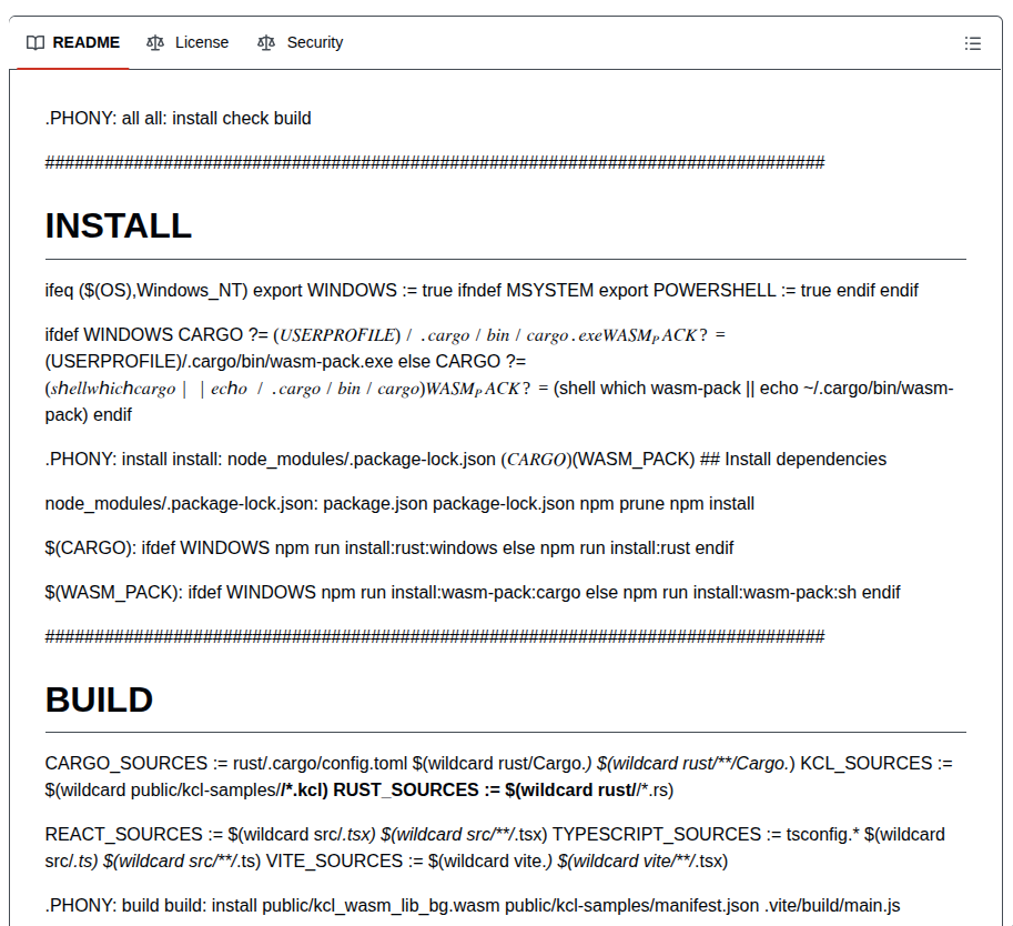

To take advantage of GitHub rendering README.md by default, I deleted our original one and symlinked the Makefile as the README.md to see how it'd render with zero changes.
the immediate result with no changes
The result is interesting! But not digestible. The universe. demands. better.

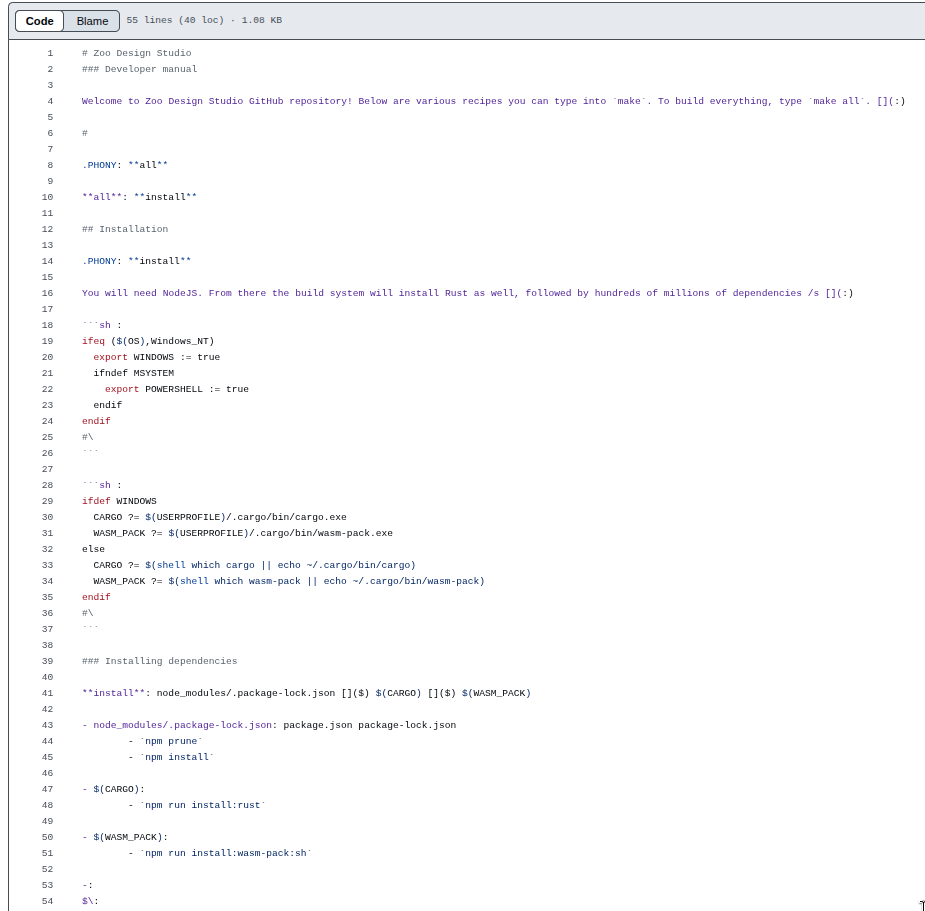

The next styling I decided to do was, unintuitively, code-blocks, because we had ifdefs in our Makefile that I couldn't imagine looking any better than as regular code. Using the reasoning above I was quickly able to find a working combination:
working code-blocks
(Not looking too bad already!)
There is one issue with this: it always leaves a trailing #\. I was happy though and left it at that. Code-blocks were particularly hard because Markdown demanded that the 3 backticks stood alone on their own line, but Makefile was not happy, always complaining about a missing separator, but we cannot use a separator due to what we just said.
To get around this, we are lucky Makefile supports what I'm going to call "line-folding", where \ is used to collapse two lines. See where we're going with this? We collapse a comment # and the 3 backticks with \ to keep Makefile happy while rendering the code-block. Phew!
Another noteworthy, interesting addition, is the abuse of Makefile's separator : to start the code-block. In Makefile's eyes, we are defining a no-op recipe, which reads "for the recipe \``sh`, do nothing". Perfect for us! In the Markdown rendering, it's completely hidden.

With this knowledge I began finding other "stylistic no-ops" much more quickly. The mental model was proving itself effective. Then I tackled plain text paragraphs finally, and I discovered what would be the final "stylistic no-op" of the evening: [](:).
It's kinda cute.
Without this combination, all my plain-text would have a colon : on the end. Using Markdown links with no text, we could effectively hide this colon!
Running the Makefile though, it complains about ) being a missing dependency. No problem, we will make this a no-op recipe! ):, done!
With that, we could define any number of useful "no-op" recipes at the bottom of the Makefile that support our Markdown styling.

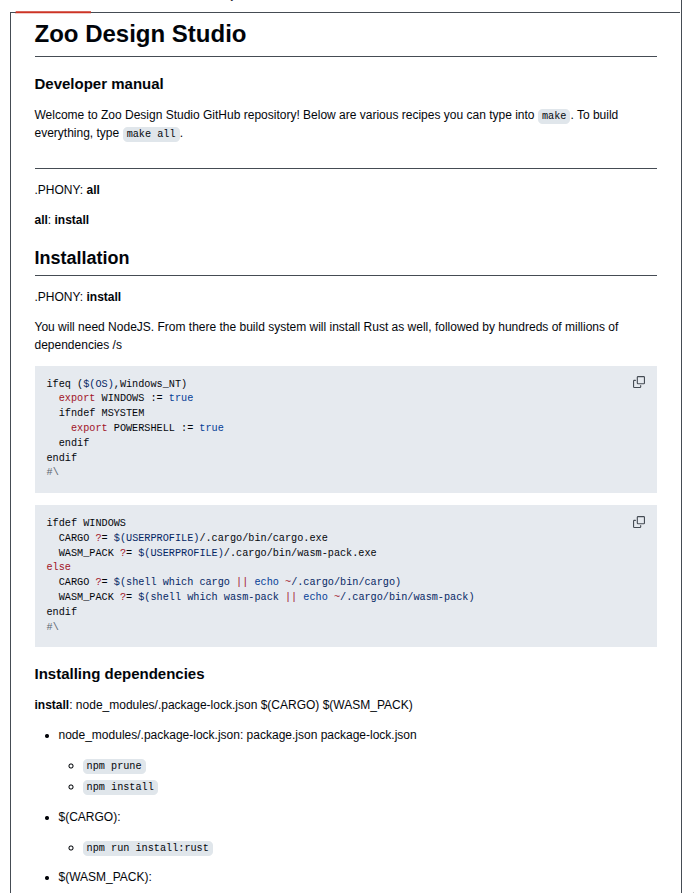

The final working Makefile.md after 2 hours, rendered in both code and visual to see their simultaneous beauty:
final file markdown final file markdown as code
